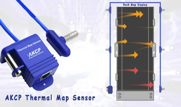

Monitoring with AKCP Thermal Maps
No system is perfect, and monitoring sensors should be in use to provide ample warning in the unlikely event that a hot spot begins to form. Of course, the AKCP monitoring solution provides data to data center operators to have critical information necessary to increase their efficiency. AKCP Monitoring can predict needed preventive maintenance and actions, such as filter replacement, which help ensure the cooling system is operating efficiently.
Thermal Map Sensors
Obstructions Within the Cabinet
