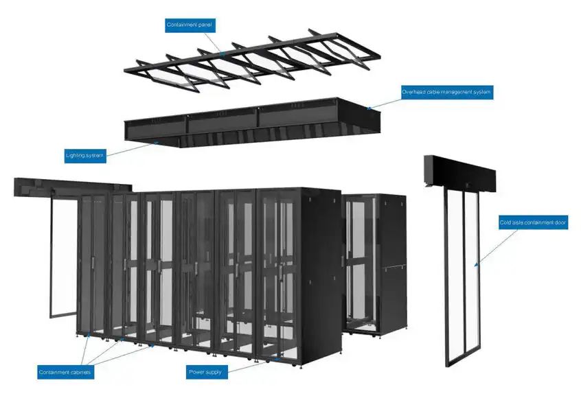

Contain Hot Or Cold Aisle Ends With Doors
To gain the benefits of aisle-end doors, you don’t need to embark on a full-fledged containment project. Because of the considerable potential for hot exhaust air to loop around the ends of rows, cabinets near the extremities of rows are the most vulnerable to elevated IT equipment intake temperatures. Aisle-end doors, whether used in hot or cold aisles, will provide significant benefits by minimizing exhaust air recirculation in this region.
There are a variety of door options available at various price points, but the major cost savings benefit comes from the opportunity to forgo the cost of full confinement. Whether you’re implementing containment in stages or making a budgetary decision, aisle-end doors are a cost-effective solution that may be implemented all at once while still minimizing IT equipment intake temperatures.
Contain The Tops Of Cabinets
The next step in containment is to contain cabinet tops on either the hot or cold aisles, which is often used in instances with high cabinet densities or when maximum efficiency is sought. To contain conditioned supply air in chilly aisles, walls, baffles, or roofs over the aisle are used. A configuration of baffles or ductwork runs from the hot aisle to the cooling unit returns in hot aisles.
There is a vast range of options and costs, just as there is with doors. Options, unlike doors, come in a wide range of styles. In most cases, full containment is unnecessary. Angled cold aisle baffles and vertical hot aisle baffles, in our experience, get the job done and are cost-effective.
