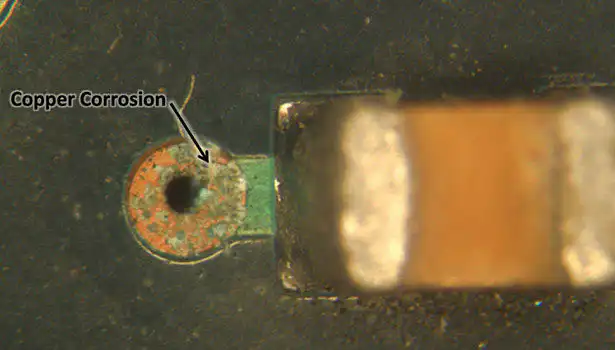

2. Corrosive Gases (SO₂, H₂S)
- Source: Industrial emissions, nearby diesel generators, decaying organic material.
- Risk: Reacts with metal components, causing silver creep corrosion and copper oxidation.
- Standard: ISA-71.04 Class G1–G3 (airborne corrosivity levels)

Advanced Corrosion Detection
In addition to standard air quality sensors, copper and silver corrosion coupons can be used to measure long-term environmental impact. These passive devices detect the level of tarnishing over 30–90 days, helping classify the airspace according to ISA-71.04 severity levels.
