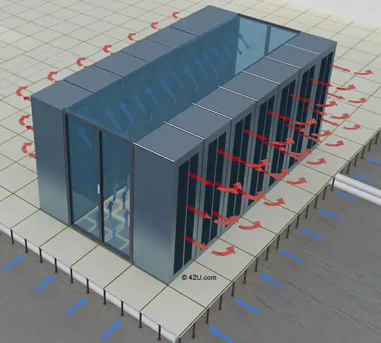

What is Cold Aisle Containment?
A cold aisle containment system (CAC) isolates that cold air through a physical barrier. This makes the rest of the room a large hot-air return plenum. Although the deployment of CRAG units works well, it may not be as effective on high-density data centers. It ensures that supply air from the cooling units is delivered directly to the server inlet through the perforated tiles. CAC solution prevents cold air from mixing with hot air, thus mitigating the risk of hotspots.
Generally, administrators think that equipment problems are caused by inadequate cooling. This is bridled by setting the air conditioning units at maximum. But this one is out of the way to energy efficiency. Retrofitting the data center into a cold aisle containment counters this inefficiency without compromising cooling.
Retrofitting Cold Aisle Containment
Cold aisle containment is easier to implement compared to hot aisle containment. This can be done quickly without having a shutdown. It is also cheaper as it works with or without conventionally raised floor cooling. Existing data centers can be retrofitted with this design without massive disruption of the facility.
Retrofitting the data center into cold aisle containment starts by arranging the racks. They should be on a hot and cold layout. The cooling unit is deployed on a raised floor outside the aisle. This can typically cool 10 to 15 kW of heat load for every rack. Curtains or doors enclose the end of the cold aisle, while ceiling panels are installed to seal the top. Furthermore, each slot of the racks must be occupied by a server. Otherwise, fillers or blanking panels should be used to cover the unused rack space
