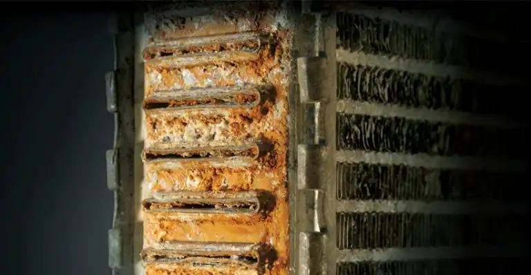

Causes And Consequences Of Corrosion
Corrosion can occur in data center-free cooling system components such as air to water heat exchangers, resulting in major efficiency and availability difficulties.

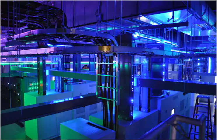

Data Center Design and Operation Requirements
Maintenance, infrastructure, and equipment upgrades occur on a regular basis. However, if not handled with care, these seemingly routine actions could result in the introduction of airborne pollutants.
Even data centers in places where air quality is not an issue may struggle to maintain a safe environment for sensitive electronic equipment due to the rising use of air-side economizers for free cooling. Any air utilized for these purposes should be purified before being introduced into the data center.
To eliminate airborne contaminants and meet warranty requirements for new IT and datacom equipment. Datacenter owners and operators must take the following action:
- Measure the corrosion rates both within and outside the data center.
- Seal all doors, windows, and wall penetrations in the data center.
- If the data center envelope is built to be positively pressurized, install room pressure monitors.
- Measure airflow at the supply and exhaust air grills, and at each computer room air-conditioning (CRAC) unit.
- Develop a temperature and humidity profile.
