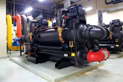

Chilled Water System. Centralized cooling of the data center hall, commonly deployed in mid to large sized data centers. Chilled water cools air that is brought in by the Computer Room Air Handlers (CRAHs). The chilled water is supplied by the Chiller Plant located in another area of the data center.

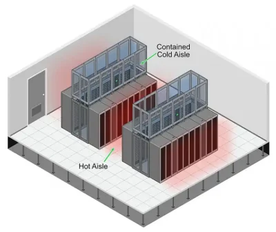

Hot / Cold Aisle Design. This is a common design method used in modern data centers. The cabinets are arranged in alternating hot and cold rows. The cold aisles are cooled so the servers can draw in the cool air. The hot air is expelled to the hot aisle. This stops the hot air mixing with the cold air. The hot air is then removed and returned to the cooling system to remove the heat from the air before being returned to the cold aisle.

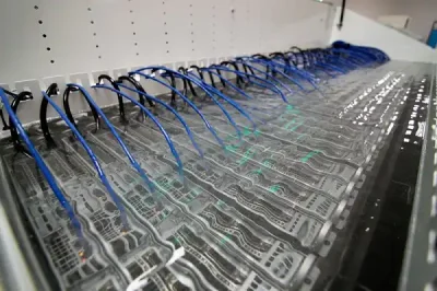

Immersion Cooling. This is a relatively new technology and is quite innovative. It uses a non-conductive and flammable dielectric fluid that the complete server is submerged in. This technology is not common.

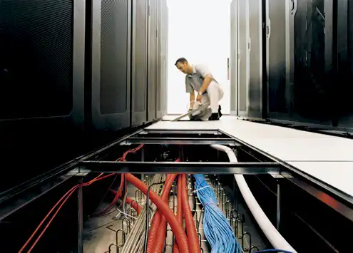

Raised Floor Leakage. Raised access flooring were popular method of data center design with cold air and callings being delivered through ductwork underneath the raised access flooring. If the raised flooring as leaks it can cause a loss of pressure as well as allowing dust and humidity to enter the cold aisle. Pressure differential sensors can be used to monitor for leaks.
Cable Openings. There are openings in cabinets and floors for cables to come through. These openings should be sealed, to prevent cold air escaping and pressure loss. Openings can be salted with cable brushes. Blanking panels with brushes can also be used to allow the bringing of cables from front to rear of the cabinets.
