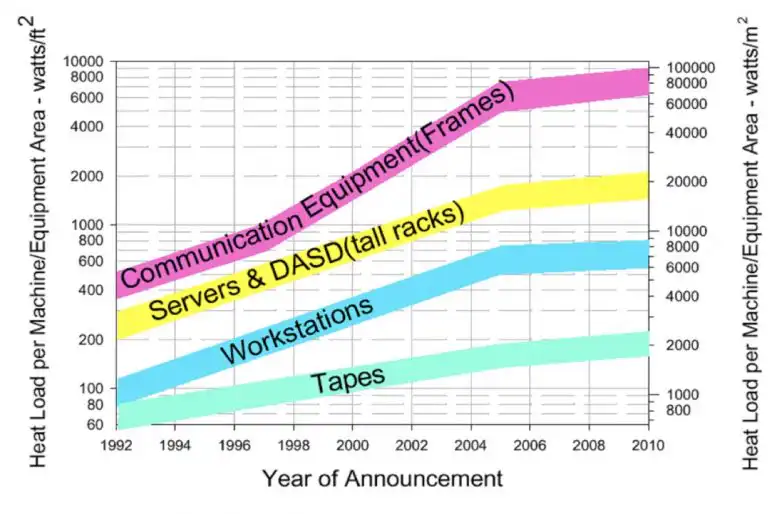

Between the years 2000 and 2005 the power consumption of semiconductors increased 60%, this means the heat produced as a byproduct of the power more than doubled during the same period. As a result significant more emphasis is being placed on the design of the data center, cooling systems and delivery of power. Additional to this, there is also a move towards higher density packing of servers within racks. This makes the use of data center space more efficient, but also increases the power needs on a per rack basis.
In 2010 server power densities reached 20,000 W / m2. Not only was this driven by improvements in semiconductor technology, but also the rising cost of data center infrastructure which pushed IT facility managers to obtain the maximum output from their data center space, fully optimizing their infrastructure. This resulted in much more attention being paid to cooling and airflow in and around the data center floor, cabinets and servers. Careful attention was paid on the positioning of server air inlets and exhausts to ensure that the hot air from one server is not being sucked into the inlet of another.

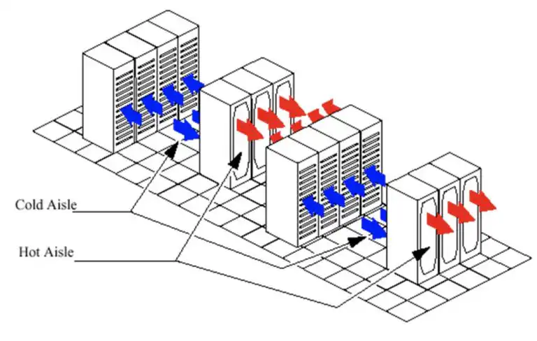

Data center designers must consider the airflow within the cabinet, and also around the whole facility. This is not only to ensure sufficient cooling capacity but also to ensure efficiencies in operation and lower power consumption for cooling systems. The PUE number can be used as an indicator as to how efficiently the power is being utilized to cool the IT equipment within the facility.
Also, the size of floor tiles for raised access flooring was standardized, so aisles could be standard widths, and cabinets fit the width of a floor tile. By manufacturers following these standards, it allows for the easier setup of hot/cold aisle containment systems, maximizing the use of the data center floor area and improved cooling efficiencies.
