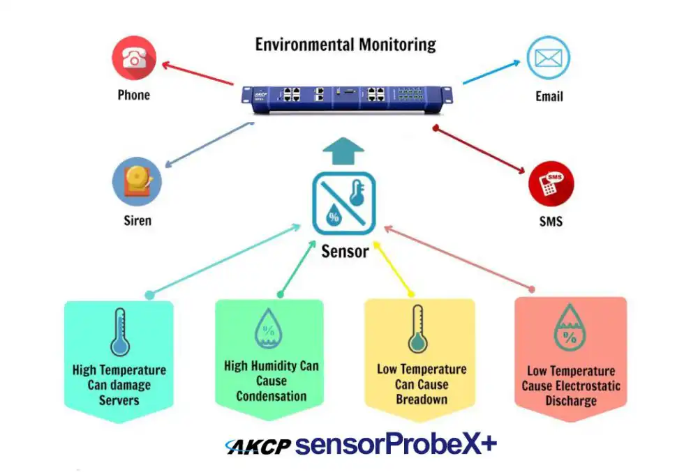

How Durable and Reliable are today’s Environmental Sensors? How Often Should Sensors be replaced?
Environmental sensors keep you updated on the overall well-being of your data center. But even the best ones do not operate indefinitely. This is the reason why one should have multiple sensors within your workplace. Intelligent data center monitoring gear is capable of monitoring all sensors simultaneously and telling you when one, or more of them, has just malfunctioned. Sensor redundancy can prevent false-positives when a sensor breaks down. Environmental monitoring requires constant vigilance when the sensor malfunctions, a swift warning must be issued to the technician on duty to remedy the situation quickly. The same goes for incidences of data error and false alarms.

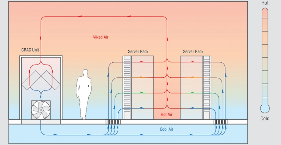

Each environment carries its own set of factors and parameters. No two are alike, there is no perfect place to put a set of environmental sensors. There’s a lot of trial-and-error going on when it comes to the correct placement of these devices. But HVAC and data center experts can do a lot of good if you consult with them. They can give you the best recommendations as to where to place your environmental sensors. So here are a few rules of thumb for your guidance:
  • Temperatures are more likely to escalate near the top and the back of the racks. So this could be a good place to gauge airflow and exhaust temperatures.
  • Temperatures tend to be cooler at the bottom and front of the racks. So this is where you read your intake temperatures.
  • Humidity is more concentrated in warmer air, which carries more moisture. So disperse humidity sensors in elevated areas free from obstruction and far from heating or cooling sources.
  • Position water sensors in low places like the bottom of racks or adjacent to drainage grates. Make sure it is lower than any elevated floor.
