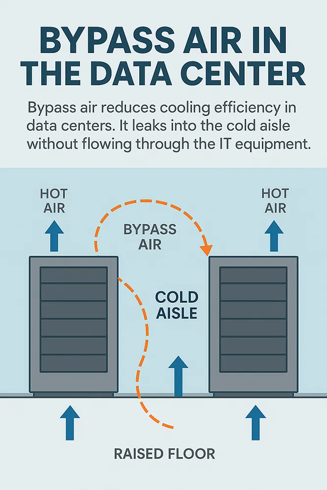

Bypass Airflow And Its Significance To Data Centers
Bypass refers to the quality air that goes past or around its intended route. In theory, cooled air will pass from the CRAC through the server and nowhere else. This is not the case for bypass airflow. Bypass air finds a route back to the CRAC air intake without passing through the IT equipment. This, therefore, means it is wasted cooling energy.

The main reason why air does not flow as intended in an IT room is an opening that circumvents the proper airflow. Unmanaged spaces will elicit more options for air to pass through. This rescinds the regular airflow pattern in the process.
Some examples of bypass openings are as follows:
  • Perforated tiles (tiles with punctures or holes in raised floors)
  • Cable openings
  • Lack of blanking panels in open spaces
The main concern from this airflow issue is it increases the unconsumed volume of air by the IT equipment. Such conditions mean that IT hardware does not fully utilize the cooling capacity of the air because it bypassed the equipment.
When this happens, cooling capacity is underutilized. More bypass air in the server racks will mean lesser cooling. Ultimately, it could mean that when servers are under increased load they get insufficient cooling. Or, your cooling capacity is over specified to compensate for the losses through bypass airflow.
