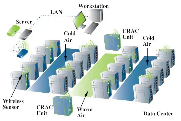

Legacy Data Center Cooling
Photo Credit: Uptime Institute Journal
For many years, the raised floor technique has been deployed in data centers. Raised floors are used to deliver cold air to the servers. The cold air from the CRAC / CRAH flood the area under the red floor with cold air. As the air is fed in it pressurizes the plenum. Perforated floor tiles allow cold air to leak out. The perforated tiles are usually located either in cold aisles, or infant of each rack. After moving through the servers, the waste heat returns to the CRAC / CRAH units to be cooled again.
Typically, the CRAC units’ return temperature is used to manage the cooling system. The CRAC unit fans operate at a constant speed. It also has a humidifier that produces steam. This has been a typical design in data centers for many years. It is still widely employed today. Raised floors are still considered a basic element in a data center infrastructure.
The legacy design in data centers depends on the principle of comfort cooling. That is, bringing a small amount of conditioned air. Then allowing it to combine with the larger amount of air available in space to achieve the right temperature. The legacy design is ideal for low-density IT equipment. Since low densities can handle poor efficiency and uneven cooling.
But now, the demand for high density data centers is increasing. This means more efficient cooling systems are needed.

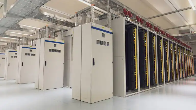

Datacenter Cooling Technology Today
Photo Credit: www.gea.com
Data center demand is increasing, be it a small edge data centers, an enterprise, or hyperscale facility. All types of data centers depend on thermal management to operate. But their demands differ based on their sizes. Cloud technology is also utilized in today’s data center cooling. Businesses are now switching to intelligent environmental sensor systems to monitor, control and optimize their data centers.
  • Large Infrastructures
In 2014, a 3 MW data center was considered a large facility. But now, 10 MW is the average facility size for hyperscale and enterprise data centers. Colocation and hyperscale customers are concerned with high-volume custom solutions that can address their needs. It offers lower costs, fewer risks, and faster speed to market.
Multi-story data centers are also becoming a trend. This reduces the expense of the real estate. It allows other cooling systems to be applied in other areas. Modern data centers can also tolerate a slightly higher temperature as advised by ASHRAE. From 18°C or 64.4°F to 27°C or 80.6°F. This means that operators can increase supply temperatures without worrying about damage.
