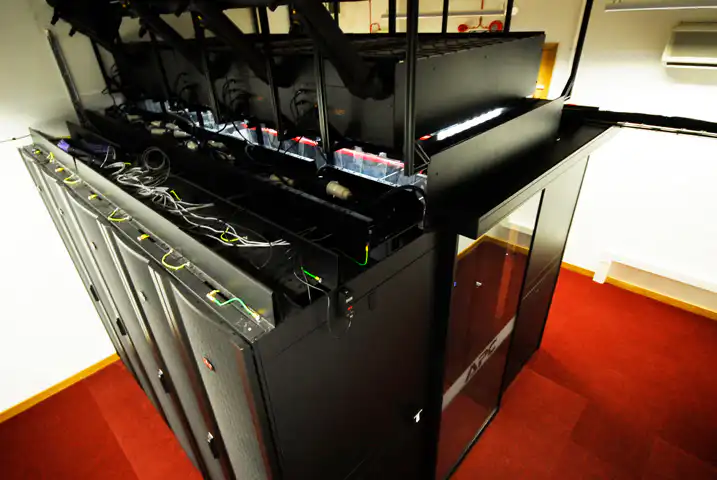

Common Myths About Airflow Containment
Airflow Containment Blocks Bypass Airflows
Bypass air is a complicated subject in data center containment. The Bypass air issue goes beyond the problem of cold air not flowing through IT hardware. Bypass airflow will only be reduced or eliminated if:
- There is a decrease in the total air volume provided by the cooling system.
- There is an increase in air volume as needed by the IT equipment.
Following these disclaimers, it is illogical to assume that air containment by itself reduces bypass airflow. The objective of data center containment should fulfill the aforementioned conditions. As such, containment efforts should focus on the right balance of air volume as required by hardware but at the same time lower the total volume emitted by the cooling units.

Perforated Tiles Are Not Needed After Containment
To debunk this myth, we must first understand the nature of containment. Containment, alone, negates the conditioned air from mixing with the hot exhaust air. However, containment does not function to balance the flow rate of the conditioned air to the flow rate needed by IT. When the flow rate is not equal, bypass air will find its way into openings. This air excesses are now wasted energy. Deploying perforated tiles is a supplement to gain better airflow balance. It is a must that perforated tiles are used in complementing any containment endeavor as it assures better cost savings in the end.
