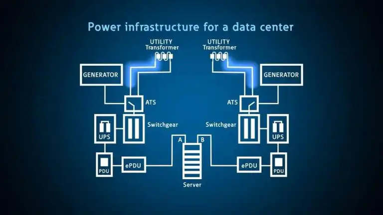

N-Modular redundancy, specifically N + 1 and N + 2, plays a pivotal role in bolstering IT system reliability. These levels of redundancy provide varying degrees of backup, ensuring the seamless operation of the system even in the face of failures. The different redundancy levels are as follows:
- N Redundancy: The baseline number of existing IT units constitutes N, representing the minimum required components for system operation. However, this level lacks redundancy, leading to system shutdown in case of failure.
- N + 1 and N + 2 Redundancy: Incorporating a single backup unit (N + 1) or two separate backups (N + 2) increases reliability. These setups allow the system to continue functioning during the failure of a particular unit, with N + 2 redundancy providing an additional layer of backup for exceptional cases.
- 2N, 2N + 1, and 2N + 2 Redundancy: These levels are built upon the baseline capacity of N. 2N redundancy implies doubling the baseline capacity, with an equal number of backup units. The 2N + 1 and 2N + 2 configurations offer further redundancy by including additional backups, ensuring optimal uptime.
- 3N/2 and 4N/3 Redundancy: Derived from the IT system’s baseload, these levels allocate redundancy capacity to ensure consistent system operation even under partial load. This approach is particularly crucial for components like power supply systems.
