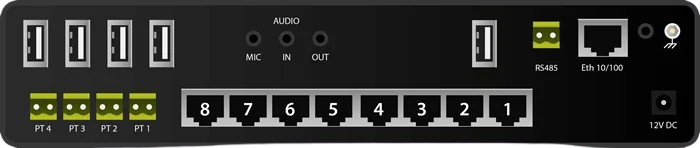

Can the expansion modules be daisy chained together, if so how many expansion modules can be connected to a single securityProbe 5E?
AKCPsecurityProbe Series, Support
Yes, the expansion modules can be daisy chained together using the RJ-45 input and output ports with normal CAT5 Ethernet cable. There really is no limitation to the amount of expansion modules that can be connected, however the securityProbe 5E supports up to 600 sensors, so it depends on how many sensors are connected in total.
