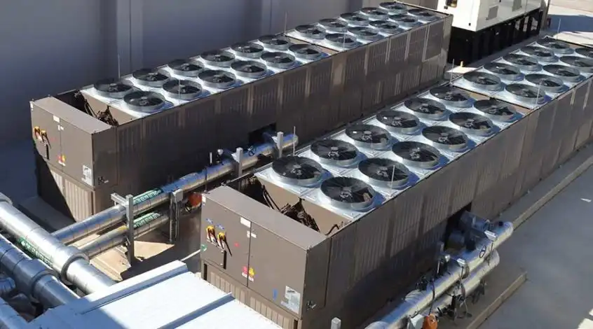

Cooling a Data Center
Computer room air conditioner (CRAC) or computer room air handler (CRAH) infrastructure is used by traditional data center cooling technologyThis combined cooling infrastructure pushes cold air through the perforated tiles and into the server intakesOnce the cold air passed over the server’s components and vented out as hot exhaust, that air would be returned for cooling. This is why return temperatures from CRAC and CRAH units are set to be the main control point of a data center floor.
Inefficiency and lack of any controls are the main concern of this deployment. Cold air is simply vented into the server room. This might be an effective strategy with the low-density deployment but not with the higher-density data floors. This is where the cold aisle and hot aisle containment concepts came from. Separating the two air maximized efficiency. In this strategy, cold air remains cold and hot air will be directed to air handlers without rising temperatures of the environment.
New data centers today have adopted many innovative cooling technologies for efficient operations. These strategies run the gamut to complex heat transfer technologies. Free cooling, liquid immersion, and many more just to save more energy.

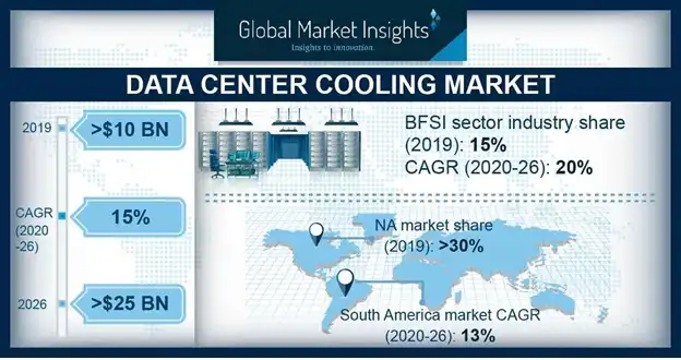

Data Center Cooling Market Growth Projections
Photo Credit: cdn.gminsights.co
A market projection from ResearchandMarkets.com indicates that there will be an average of 3% between 2020 and 2025. This only proves that the data center cooling market has an ongoing interest.
Furthermore, a Market Study report published different yet similar findings in December 2017. This study also indicates a growth related to technology.
The trend of data centers built in third-world countries is rising. And that’s one of the biggest factors of this anticipated growth. Analysts believe that the facilities’ efficiency will be emphasized once data centers start their major operations in these countriesThis, naturally, triggered the need for more innovative cooling technologies such as liquid cooling.

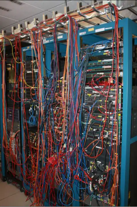

1. Bad Cabinet Layout
Not planning the arrangement of your data center cabinet is a big mistake. Arranging cabinets without a systematic design is equal to a waste of money and resources. An ideal cabinet layout should include a hot aisle and cold aisle containment design. In this design, a CRAH should be at the end of each row to gather the exhaust hot air and return it as cool air.
Photo Credit: www.cisco.com
