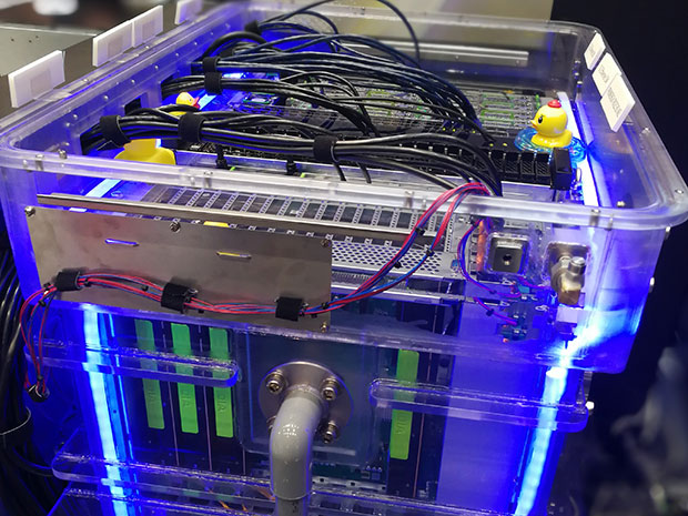

Cloud Computing and Artificial Intelligence (AI) bring a new generation of technology with high-performance processors and increased rack density. This corresponds to more heat, transcending the capability of traditional air cooling methods. Direct liquid cooling is now on the rise as an innovative, high-density data center, cooling solution. While air can cool racks up to 20-30 kW, direct liquid cooling can surpass this to beyond 100kW.
Direct liquid cooling is the use of dielectric fluids to dissipate heat from the equipment. It was introduced by IBM in the 1960s. The servers are submerged in a dielectric fluid that carries away the heat and is pumped through a heat exchanger.
Direct liquid cooling is gaining traction today because of the benefits it offers. By capturing the heat directly from the source, hyper-scale data centers can achieve greater reliability. A report by Global Market Insights forecasts that the data center liquid cooling market will escalate to $2.5 billion by 2025 from $750 million in 2018.
Energy Efficiency
Concern over rising energy costs is one of the major reasons for the domination of direct liquid-cooling solutions. The Natural Resources Defense Council (NRDC) has stated US data center power consumption was 70 billion kilowatt-hours in 2014, escalating to 140 billion in 2020. This is equivalent to the annual output of 50 power plants and a cost of around $13 billion in annual electricity bills. Although the cost per kWh rates differ across the globe, electricity prices are adjusted mainly based on Locational Marginal Pricing (LMP). With direct liquid cooling, high-density data centers may achieve a PUE of less than 1.2 without overspending on cooling. It eliminates the air handling systems cutting the cooling power demand. It can also leverage 45°C (113°F) water for cooling. This allows for compressor-less cooling, most of the year in many climates. Another opportunity is to re-use the heat by directing the heated liquid to the building’s heating system. Achieving energy efficiency guarantees an increased return on investment (ROI).

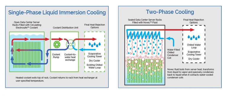

Categories of Direct Liquid Cooling
Direct liquid cooling can be categorized based on the method of cooling at the chip level. The main methods are single-phase cooling and two-phase cooling.
Photo Credit: www.grcooling.com
  • Single Phase Cooling
Single-phase means that the fluid doesn’t change state while taking away the heat. In this method, the liquid cools the hotter component. It uses a cold plate on the chip so components are not in direct physical contact with the liquid. With this, air coolers are still needed. The fans provide airflow through the server to remove the heat. The fluid is distributed through a water manifold at the back of the rack. A water manifold is a section of pipe that has built-in ports in it designed for this function.
  • Two-Phase Cooling
Two-phase cooling means the fluid changes state as it removes the heat from the server. It uses engineered dielectric fluids as its liquid coolant. When it comes to heat rejection, this method can be a better option. However, this requires additional maintenance to achieve greater effectiveness.
