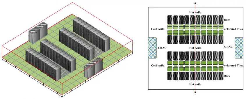

Hot Aisle Containment
- A 30% cooling efficiency increase
- Easy installation process compared to other grid systems
- No need for additional trades on site
- No mixing of hot and cold air as containment separates the airflow
Cold Aisle Containment
The biggest consideration in a cold aisle containment system is the crucial role of airflow controls. Cold aisles work to facilitate a uniform level of cold air to flow into the IT equipment. To manage the constant level, airflow controls are needed to predict the supply of air for a particular aisle. A predicted airflow prevents hot spots. It also highlights optimal operating efficiency. Ultimately, cold aisles work best to provide intake air temperatures at a constant setpoint.
There are also different modes of configuration for a cold aisle. Again, this is dependent on the performance demands a data center works for. It comes in these basic forms:
- Single or Double Sliding Doors with a Hard Roof.
- Hard division along with Single or Double Sliding Doors.
- Soft divisions incorporated with Strip Doors.
- Single or Double Sliding Doors alongside Directional Airflow Panels.

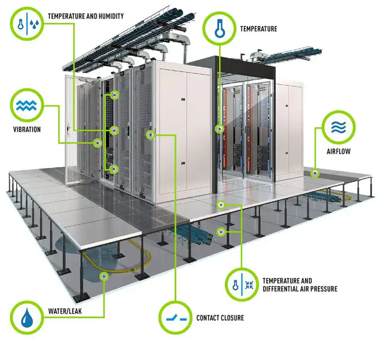

Sensors As Containment Optimizers
- In a cold aisle containment system, AKCP dual temperature and humidity sensors can check and maintain aisle temperature. The constant gauge can ensure that aisle is in standard condition and is not extracting too much energy because of cooling.
- For IT cabinets along the aisle, AKCP temperature sensors can be placed at the front and rear, top, middle, and bottom. It can predict temperature differential from the front to rear providing better data oversight when monitoring.
- To check airflow in cold and hot aisles, AKCP air pressure sensors check on pressure differences to prevent hot air from mixing in the cold aisle.
- Incorporating an intelligent monitoring system requires other sensors to check on water leaks and access controls. The rope water sensors by AKCP can be positioned under access floors, at different rack levels, and aisle access enabling better control.
