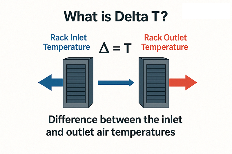

Understanding Delta T: More Than Just a Number
Delta T is commonly defined as:
ΔT = T_return – T_supply
This value represents the thermal energy removed from IT equipment, with T_supply typically measured at the front intake of server racks and T_return at the rear exhaust or CRAC/CRAH return vents.
However, measuring Delta T is not a one-size-fits-all calculation. Consider the following contexts:
CRAC/CRAH-level Delta T gives a macro-level overview of room cooling efficiency.
Rack-level Delta T captures micro-level inefficiencies, revealing recirculation or bypass conditions.
According to ASHRAE TC 9.9, maintaining an intake temperature between 18°C to 27°C (64.4°F to 80.6°F) is acceptable for most IT equipment. But the Delta T value itself can vary depending on airflow strategies, server densities, and cooling methods.
An optimal Delta T is typically within the 10°F to 20°F (5.5°C to 11°C) range. Values significantly lower or higher suggest cooling anomalies:
Too Low (e.g., 3–5°C): Cold air bypass—excess cooling not utilized.
Too High (e.g., 12–15°C+): Recirculation—hot exhaust air is mixing with intake.
