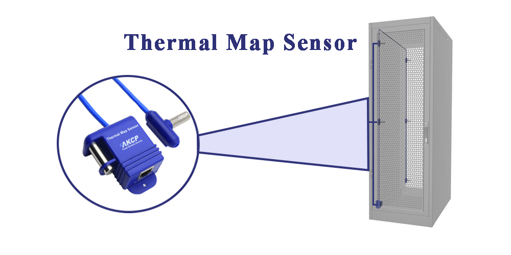

Thermal Map
Untitled-1lkjh-e1626171372616-300x288
Pre-wired to be easily installed in your cabinet, they are placed at the top, middle and bottom front and rear of the cabinet. This configuration of sensors monitors the air intake and exhaust temperatures of your cabinet, as well as the temperature differential from the front to the rear. Use thermal map sensors to identify cabinet hot spots and problem areas.
