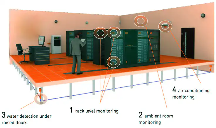

Areas Of Consideration In Environmental Monitoring
The cooling system is a necessity in the data center. It maintains the right environment for the IT equipment. Cooling systems must be efficient to avoid wasting energy costs. Operators must also know the areas of the facility that need more cooling.
Furthermore, the CRAC unit is responsible for maintaining the temperature. As well as humidity and air distribution in the data center. It is important to know if the CRAC unit is functioning efficiently. Here are the certain areas in the facility that need crucial monitoring.
Floor
The air pressure sensors monitor the cold air under the floor. They indicate if there is enough cooling in this area. If the cold air is inadequate, remove any obstruction that affects the cold airflow. This leads to a low cold air supply.
Racks
Monitor rack temperatures. You can do this by placing a sensor at the rear and top parts of the rack. These areas have the highest temperatures. Hence, you need to track the airflow and exhaust temperature here. Monitor the airflow and intake temperature as well at the bottom of a rack. This area has the lowest temperature in the rack. If your facility has an aisle containment you can put environmental sensors in the aisles. This will allow you to track the cooling zone.
Room
Of course, you must monitor the whole environment of a room. Look for hotspots around the area. Feel the temperature as well as the humidity of the room. You may place environmental sensors in high open areas. Where there is no direct heating or cooling source. This will help you get a neutral feel of the environment.
