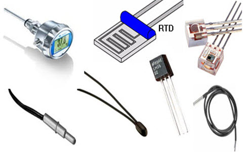

Types of Temperature Sensors
Temperature sensors are used on a daily basis for building temperature management, water temperature regulation, and refrigerator control. Temperature sensors are also used in consumer, medical, and industrial electronics.
Temperature sensing requirements may vary by application. What’s being measured (air, mass, or liquid), where it’s being measured (inside or outdoors), and the temperature range being monitored are all factors to consider. The thermocouples, resistance temperature detectors (RTD)thermistors, and semiconductor-based integrated circuits are the four most popular types of temperature sensors in modern electronics (IC).

The most common type of temperature sensor is the thermocouple. They are utilized in a variety of industries, including manufacturing, automotive, and consumer goods. Thermocouples are self-powered, do not require stimulation, and respond quickly. They can function at a wide range of temperatures.
Thermocouples are manufactured by connecting two metal wires that are not the same. There is a Seebeck Effect as a result of this. The Seebeck Effect occurs when a temperature difference between two different conductors results in a voltage difference between the two substances. This voltage difference may be measured and used to compute the temperature.
Thermocouples come in a number of shapes and sizes and are constructed from a variety of materials, allowing for a wide range of temperature ranges and sensitivities. The various categories are distinguished by the letters assigned to them. The K-type is the most often utilized.
The fact that thermocouples have a limited output voltage, which necessitates accurate amplification, as well as their sensitivity to external noise via long cables and cold junctions, makes temperature measurement difficult. The thermocouple wires contact the copper traces of the signal circuitry at a cold junction. This results in a second Seebeck Effect, which must be adjusted using a technique known as cold junction compensation.
  • RTD (Resistance Temperature Detector)
The resistance of any metal changes as the temperature changes. RTD temperature sensors are based on this differential in resistance. A resistor with well-defined resistance vs. temperature properties is known as an RTD. The most popular and accurate material used to create RTD is platinum.
PRTD is another name for platinum RTD. At 0°C, they are frequently available with resistances of 100 and 1000. They’re known as the PT100 and PT1000, respectively.
Platinum RTD is employed because they have a nearly linear temperature response, is stable and accurate, produces reproducible responses, and has a broad temperature range. Because of their accuracy and reproducibility, RTD is frequently utilized in precision applications.
RTD elements usually have higher thermal mass, and therefore respond slower to changes in temperature than thermocouples. Signal conditioning is important in RTD. They also require an excitation current to flow through the RTD. If this current is known, the resistance can be calculated.
Configurations include two, three, and four-wire options. The two-wire option is useful when the lead length is short enough that resistance doesn’t significantly affect measurement accuracy. A three-wire adds an RTD probe that carries the excitation current. This provides a way to cancel wire resistance. Four-wire is the most accurate, as separate force and sense lead eliminates the effect of wire resistance.
  • Thermistors
Temperature variations induce quantifiable resistance changes in thermocouples, which are comparable to RTD. Thermistors are often constructed of a polymer or ceramic. Thermistors are often less expensive than RTD, but they are also less precise. The majority of thermistors come in two-wire layouts.
The most often used thermistor for temperature measurement is the Negative Temperature Coefficient (NTC) thermistor. The resistance of an NTC thermistor reduces as the temperature rises. The temperature resistance of thermocouples is non-linear. To appropriately understand the data, this necessitates a large modification.
  • Semiconductor Based ICS
There are two types of temperature sensor IC based on semiconductors: local temperature sensors and distant digital types of temperature sensors. Local temperature sensors are integrated circuits that use the physical attributes of a transistor to monitor the temperature of their own die. The temperature of an external transistor is measured using remote digital temperature sensors.
Analog or digital outputs are available for local temperature sensors. Digital outputs come in a variety of forms, including I2C, SMBus, 1-Wire, and Serial Peripheral Interface (SPI). Analog outputs can be either voltage or current. The temperature of printed circuit boards or the ambient air surrounding them is sensed using local temperature sensors.
Remote digital temperature sensors use the physical features of a transistor to function similarly to local temperature sensors. The transistor is separated from the sensor chip in this case. A bipolar sensing transistor is included in some microprocessors and FPGA to measure the target IC die temperature.
