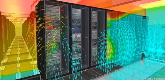

1) Eliminating hot spots
Hot spots in a data center are not caused by inadequate cooling capacity, but rather by problems with the cooling’s airflow — the chilled air is not reaching, or not evenly reaching the IT equipment. Data center operators can resolve airflow issues by bringing the cooling systems and the airflow closer to the heat load, and ensuring that the chilled air does not mix with the hot exhaust air of the IT equipment.
